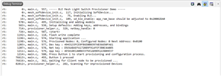

The board is made with the nRF52832 chip and can not be scanned during the test. Could you tell me why? The nRF52 DK board functioned normally. The platform used a mesh light switch provisioner. attach the photo.
What example(s) have you provisioned on the other board(s)?
Other boards were mesh light switch servers.
Which mesh sdk version did you use? Did you remember to erase all of the boards before flashing the applications? If you have not already seen this documentation here, I would recommend taking a look.
I used the latest version that came up on the site. I also erased all the boards. I do not know why.
If you open the release notes document, you should be able to see which version you downloaded.
