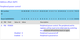

According to <nRF52832_Rev_1_Errata_v1.8>
It is mean below?(spi with blocking mode)
    nrf_drv_spi_init(&m_inst, &spi_conf, NULL);
    nrf_drv_spi_transfer(&m_inst, &pkg[0], 2, NULL, 0)
	nrf_drv_spi_uninit(&m_inst);
	*(volatile uint32_t *)0x40003FFC = 0;
	*(volatile uint32_t *)0x40003FFC;
	*(volatile uint32_t *)0x40003FFC = 1;
But I think it should be this
when transfer complate ,should I close the power of spi,not open the power of spi,is it right?
