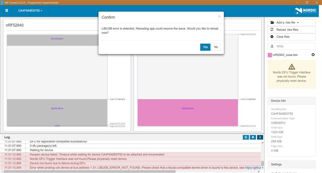

    I flashed a dongle with Connect app using NCP for border router example hex from SDK:
    nRF5_SDK_for_Thread_and_Zigbee_2.0.0_29775ac\examples\thread\ncp\usb_bootloader\hex
    It seems that software is flashed, but I just want to know if this behavior is normal (photo attached).

  • The message in nRF Connect is normal when you flash an example that implements USB on the nRF IC. I was referring to the project settings in NCP example in Segger Embedded Studio. Changing the linker file used by GCC should give similar results. Which example did you build using GCC?
    1. Yes, the dongle use our serial DFU solution over USB to flash the IC. It will not allow you to overwrite MBR/Bootloader.
    2. Sorry, I meant to write MBR and not Bootloader. Bootloader is, as you correctly mention, placed close to top of flash.
