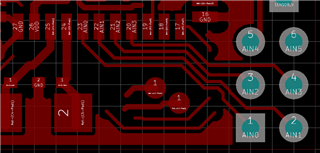

I'm developing on a Laird BL652 module mounted to a custom PCB. Issue is that AIN0 and AIN1 return reduced values from what AIN2-AIN5 are showing. For this example, all pins on my device (AIN0-AIN5) are connected to steady VDD.
UART Output
PCB Layout
Layout is very straightforward.
