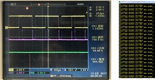

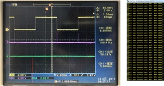

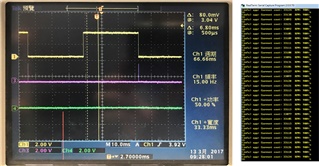

NRF52840 Timer2 Capture and Compare question?
1.I used Timer2 Capture function
Time Frequency is 1MHz.
Picture1 Current counter should be 33330.
Picture2 Current counter should be 5000.
Picture3 Current counter should be 665.
But the counter is smaller, Can you tell me?
