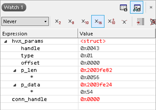

  • Hi Edvin,
    it doesn't complain. It always returns NRF_SUCCESS.
    p_len is 86 Byte (I'm trying a fixed string at the moment), the array is fine.
