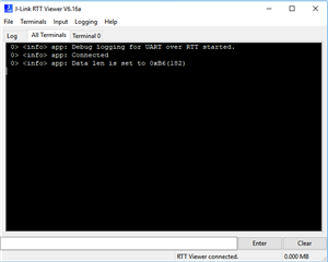

    I tested just now with the unmodified example from SDK15.2.0, and the log output is like this when I connect with an iPhone 8:
    I then modified the example to send a dummy array of size 182 with some random numbers whenever the uart handler triggered, and it was sent with the return value NRF_SUCCESS, and I received this array on my phone when notifications were enabled.
    Can you check the log output when you run your application. I don't know what your pcb looks like, but if you are able to program the chip, you should be able to view the RTT log using the same application as in the screenshot above.
