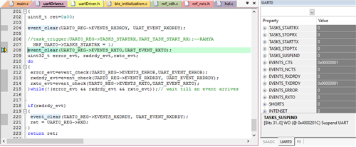

I am implementing the UART on NRF52840. TX works but the RX doesnot. While debugging, I noticed that STARTRX task register is not getting set due to which the RXDRDY event is not getting detected. Below are the code snippets of Tx and Rx functions. Can you please help me resolve the issue.

    Your line:
    }while(!(error_evt && rxrdy_evt && rxto_evt));// wait till an event arrives
    will return when you get one of the three: error_evt != 0, rxrdy != 0  or rxto_evt != 0.
    While in the driver, nrfx_uart.c, which is used in the example:
    while ((!rxrdy) && (!rxto) && (!error))
    will not return until all three are 0.
    So it might be that you get a timeout or error before you get a message, and the application moves on.

    In the debug window, I see that RX task is not being triggered. Latest project attached.
    Ramya
  • The RX task is being triggered if I send one char at the time.
    I see that the way you receive the rx_data is not working. It is a pointer problem. Try to change the main() function to this:

    Also, I see that you don't start the project when you upload it via Keil.
    Go to project settings -> Utilities -> Settings -> Flash Download -> and check off "Reset an Run". Then it will start when you upload the project.
