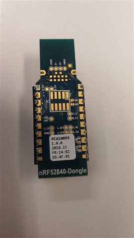

The problem its that the device which I receive is not the same that appears in the stick device, I attach photo:
Could anyone tell me that I'm do it correctly?

  • Ah, its a Static Random address see this post - that's why the last 2 bits in the serial bit stream are both '1' - this is the most sig top 2 bits in byte 5 in your packet[] array. (Each byte in the array are transmitted least significant bit first in the serial bit stream).
    Note that even though the address is "Random", it is invariant and never changes for a specific Nordic device as the NRF_FICR->DEVICEADDR registers are Read-Only.

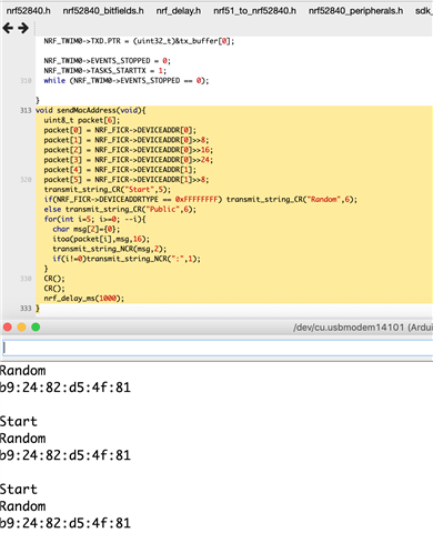

  • I understand that in BLE Steam the 2 MSB bits of the address depends of the type of address as you attached in the comment before. But in this case we're reading a register, that could be use as on-air address or I could make my own address, so I think that there are other reason for this case.

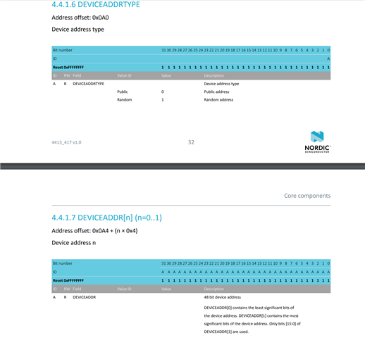

    Also, as I can saw in the Product Specification Docs, there is a register in which appears the type of address:
    As we can appreciated if the register is 0xFFFFFFFF its a Random Address, and if the register is 0xFFFFFFFE, it's a public Address. I attach the code:
    void sendMacAddress(void){
      uint8_t packet[6];
      packet[0] = NRF_FICR->DEVICEADDR[0];
      packet[1] = NRF_FICR->DEVICEADDR[0]>>8;
      packet[2] = NRF_FICR->DEVICEADDR[0]>>16;
      packet[3] = NRF_FICR->DEVICEADDR[0]>>24;
      packet[4] = NRF_FICR->DEVICEADDR[1];
      packet[5] = NRF_FICR->DEVICEADDR[1]>>8;
      transmit_string_CR("Start",5);
      if(NRF_FICR->DEVICEADDRTYPE == 0xFFFFFFFF) transmit_string_CR("Random",6);
      else transmit_string_CR("Public",6);
      for(int i=5; i>=0; --i){
        char msg[2]={0};
        itoa(packet[i],msg,16);
        transmit_string_NCR(msg,2);
        if(i!=0)transmit_string_NCR(":",1);
      CR();
      CR();
      nrf_delay_ms(1000);
    And I see by serial port:
    I have test that and the results are that there's a random address, so I don't understand why and don't correspond with the "public address" of the label.

  • The address on the label is actually "Static Random", not "Public". You cannot change the DEVICEADDRTYPE register as it is also read-only. Nordic appear to hardcode the psuedo-random 48-bit address and then set the upper 2 bits within the SoftDevice stack to indicate "Static Random". These 3 registers can not be changed.
    If you want your own BLE "Public" address I believe you can set it using sd_ble_gap_addr_set() which you can find in the Infocenter. However it looks to me like your decoding is correct and matches the label provided you always set the upper 2 bits.
