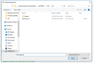

    How to add files:
    Right click on either a folder in your project or the project name (in my case "Project 'ble_app_template' ")
    There are two options you can use:
    Add New File... : Creates a blank file in your project
    Add Existing File... : Imports a file in your project
    Add New File... option:
    Here you select the file type and give it your desired name.
    Add Existing File... option:
    Here you have to navigate to the file you wish to include, in my case for examle ble_cus.c, when I have found it in its location i select it and open it.
    Here is my result, I have created a new file called ble_nus.h with the Add New File... option and imported a file called ble_cus.c with the Add Existing File... option.

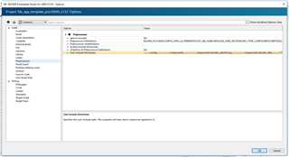

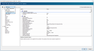

    How to include header files:
    Right click on the project ("Project 'ble_app_template' " in my case), and click on Edit Options...
    In the Project Options window that opens, select the option Common under Private Configurations:
    Click on the Preprocessor option:
    Add the path to the folder that contains the header file you wish to include in the window that opens and click OK:
    Note that  ../../../../../../ is needed because the path is relative to the .emProject file in the ses folder which opened the project.

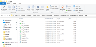

  • Hi Andrea,
    Actually i do have these files in the path mentioned in the error.
    You can see the path and file in my attached image .
    What could be the problem now?

    Please look at my first reply under "How to include header files:". It should be quite easy following those steps.
    - Andreas
