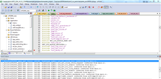

nrf52840 sdk 12.3 to 14.2 how to solve this linking errors,please help me
Have you enabled the drivers in sdk_config.h?
Inside nrf_drv_clock.c for example, there is a macro "guard":
#if NRF_MODULE_ENABLED(CLOCK) ... driver code ... #endif
To enable the driver you need to define:
#define CLOCK_ENABLED 1
inside sdk_config.h. You can read more about who to use the sdk_config.h file here: nRF5 SDK v14.2.0: SDK configuration header file
