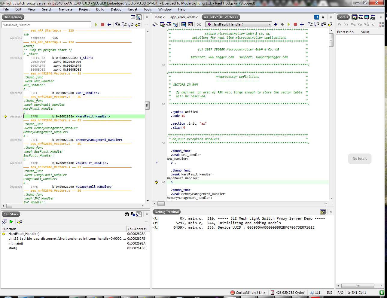

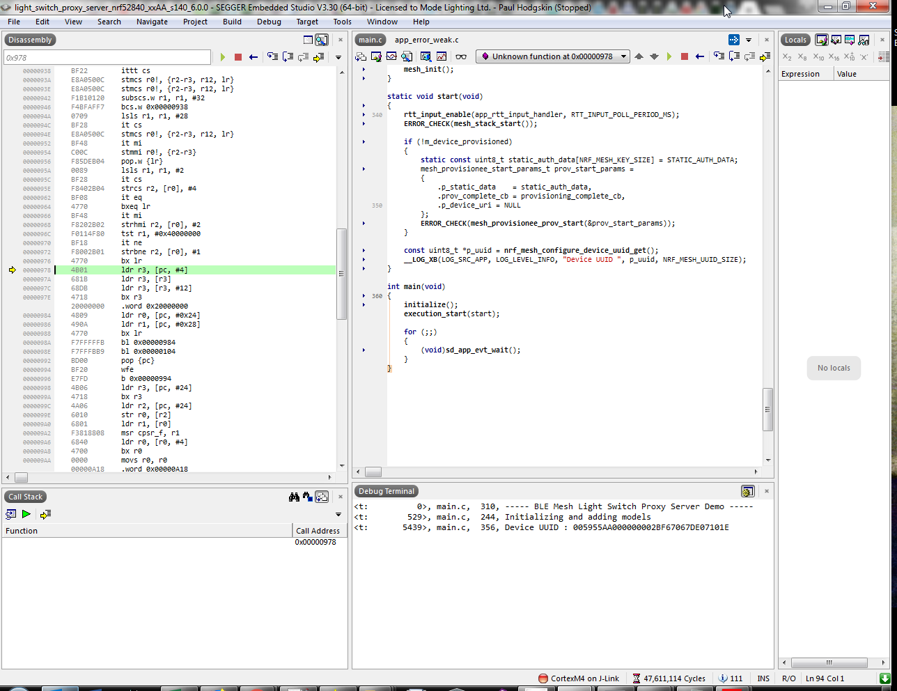

    After a while (sometimes a few minutes, sometimes hours) the debug session stops if i then click the play icon to continue, it jumps to the fault vector.
    I have added two screenshots to show this. The first is after the debugger stops itself. The stack trace is empty and it shows that it seems to try to go to an unknown function at address 0x00000978. When debug is resumed it goes to the hard fault handler as shown in the second screenshot.
