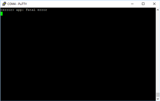

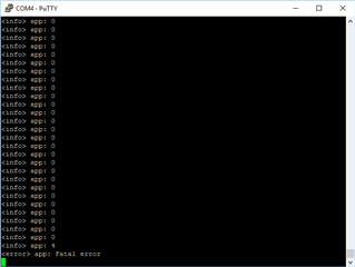

I am using the ble_blinky example (s132) and want to increase the number of characteristics. I get the error code 4. I think the storage capacity is not the reason why I can't create more characteristics. In the a try I implemented some variables to see if I can still create the same number of characteristics, and yes I can. I read in some old Posts about a limitation for the GATT Table or the number of characters per service but I couldn't find these parameters anymore.
I tried with the the is_value_user parameter as well. Maybe I haven't used it right but the number of characteristics didn't increase and reacted the same way like before.

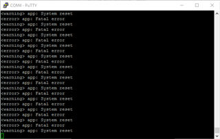

    As Steve suggested, you may need to increase NRF_SDH_BLE_VS_UUID_COUNT. In addition to this you may also need to increase the RAM size allocated for the Softdevice. If you enable the NRF_LOG module you will get a message if this is necessary. To enabled NRF_LOG go to sdk_config.h and search for "NRF_LOG_ENABLED"
    // <e> NRF_LOG_ENABLED - nrf_log - Logger
    #ifndef NRF_LOG_ENABLED
    #define NRF_LOG_ENABLED 1
