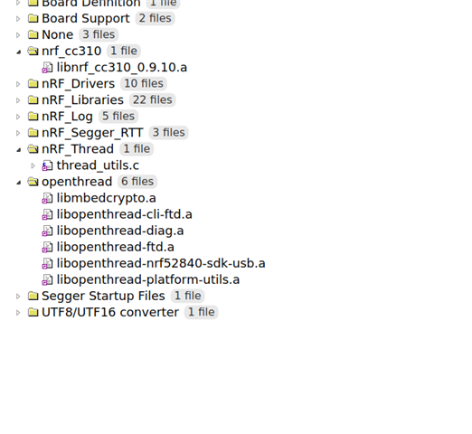

  • Hi, Jorgen
    Thanks for your reply. I got the following error log when building cli example using libmbedcrypto.a in SES at link stage:
    1> Linking sh_firmware.elf

    And the libs I included are as follows:
    Any idea?

  • Both NCP (UART) and CLI (UART) should be using HW version in Therad and Zigbee SDK v2.0.0. Which exact example did you use that used the software version?
  • Hi Jorgen
    I am using cli usb example in Therad and Zigbee SDK v2.0.0. And the the default library is the SW version in my downloaded package.
    BTW there are errors as well when building the ncp spi example using the software version.
    Thanks
    Best wishes
    Bo
    I was able to reproduce this issue. It seems that the nrf52840-sdk-usb library used by this example have been built with HW crypto support disabled. The solution is to rebuild the library with HW crypto support. This can be done by removing the flag "DISABLE_CC310=1" on line 110 and 141 of the Makefile found in "nRF5_SDK_for_Thread_and_Zigbee_2.0.0_29775ac\external\openthread\project\lib\openthread_nrf52840\sdk\usb\armgcc\Makefile", and recompile as described in above link.
    For your convenience, I have attached rebuilt library that should solve the issue: libopenthread-nrf52840-sdk-usb.a
    Please replace the file in "nRF5_SDK_for_Thread_and_Zigbee_2.0.0_29775ac\external\openthread\lib\gcc" with the attached file.
    I have notified the developers and this issue should be resolved in next release of SDK for Thread.
    Jørgen
