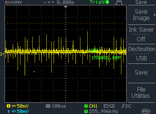

  • The nRF52 product spec is a little deceiving in that you can only sample 8 channels with the SADDC not 9.  The block diagram makes it look like you can do this but you can't.  If you look at the channel selection registers CH[X].PSELP and CH[X].PSELN that control the MUX there are only 8 registers. So you can only sample 8 channels.  If you want to sample all 8 channels VDD must be one of them, I know because I tried this as at one point.
    Lines 176 in your code should cause an assert when called.  What version of the SDK are you using?
  • Thanks for the advice, I've commented out one of the AIN pins and now the VDD looks to be correct at just over 3.3V but the others are still jumping around 200mV.
    I've just tried measuring AIN4 with a multimeter and I get around 150mV. I also scoped it and this is the result, Vpp:180mV.
    Also, in my first comment the values were around 2V but I discovered if I take the foam which came on the pins off it drops to the 200mV range so I guess that foam was slightly conductive.
    I'm using a makerdiary nRF52840-MDK IoT Development Kit with nRF5_SDK_15.0.0_a53641a.
