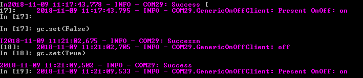

When using the script interactive_pyaci.py together with ipython and the serial example, I observe a strange formatting in the command window, because the "In [..]" is often printed out somewhere in the middle of the output data stream of the device. I think, the terminal itself, as well as the example code on the nrf, do not cause this problem. What I do understand, is, which part of software is responsible for printing out the "in [..]" expression. Please help, thanks.
The following screenshot shows a sequence from the "Sending mesh packets" example...

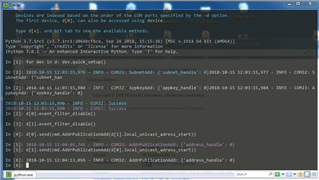

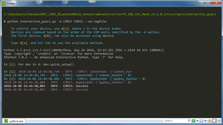

The formatting that I am expecting, is like this...
In [1]: for dev in d: dev.quick_setup()
2018-10-08 10:01:53,154 - INFO - COM17: SubnetAdd: {'subnet_handle': 0}
2018-10-08 10:01:53,157 - INFO - COM17: AppkeyAdd: {'appkey_handle': 0}
2018-10-08 10:01:53,158 - INFO - COM17: Success
2018-10-08 10:01:53,161 - INFO - COM33: SubnetAdd: {'subnet_handle': 0}
2018-10-08 10:01:53,162 - INFO - COM33: AppkeyAdd: {'appkey_handle': 0}
2018-10-08 10:01:53,166 - INFO - COM33: Success
