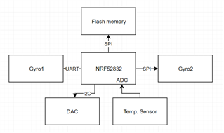

I didn't understand the function of softdevice. I have a custom nrf52832 board. My requirements;
-2 uart,2spi,1i2c
-OTA update
Should i use a softdevice in nrf chip? Can i do OTA update without using softdevice?

You need the SoftDevice when you want to use Nordic's Bluetooth Low Energy implementation. When you don't use Bluetooth Low Energy, or use a 3rd party implementation, such as nimble, there is no SoftDevice required.
When you mention OTA update, this suggest you will use the Nordic's Bluetooth Bootloader, which requires the SoftDevice.
