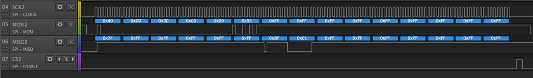

I have a custom board on which I am running the fatfs example from SDK15.2.
On SD Card Initialisation the CMD0 response is unexpected: -
ScreenShot showing 0xBF where NCR expected
Where the NCR would be expected, there is a return of 0xBF. This does not look like R1 with 0 NCR as R1 should have the first bit 0.
The impact of this is the app_sdcard.c rejects the response as R1 & 0x3 is non-zero (app_sdcard.c:533) and the thread is terminated.
     SDC_RESP_CHECK(SDC_PT, r1);
Any idea why this is happening? I've tried the same code on the nRF52-DK and it works as expected.

  • I think the configuration for MISO should be PULLUP? In the example it's set to PULLDOWN (at least if I look at the P0 configuration in SES it shows it as pulldown, and if I change it at that point to be PULLUP it seems to work).
    I'll try putting a proper fix in to see if that changes things.
  • Yes - that fixed things. I found this was in the sdk_config.h file

    Perhaps I should put a pull-up on the board...
