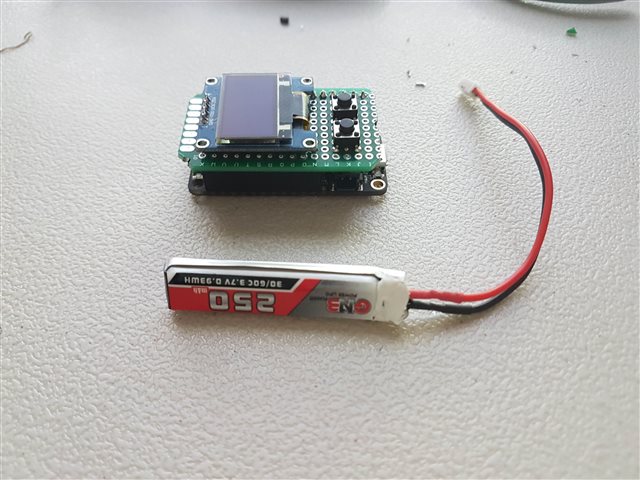

  • I understand that I will be steered towards using the nrf52840 DK board, but I need this SoC to be inside a small prototype for testing its suitability for a particular project. I would like to test power consumption of the nRF52840 in a functional prototype without creating a custom PCB. The dongle is the ideal starting point for such testing if I can get my software to run on it.
