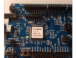

May i know how can I get the Segger Id of the Board?

    The Segger ID can be read on the label located on the Segger chip:
    My ID on this development kit is 682266227
