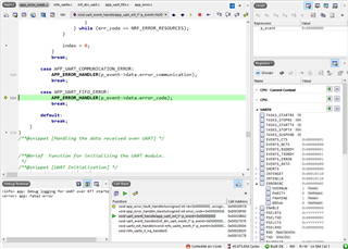

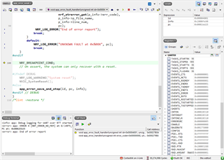

  • Thank you Edvin! I didn't enable debug config because I was actually running the example for PCA10040e as I wanted to run the example on nRF52810's limited resources.
    Anyway, I tested following setups -
    1. Changed the UART source MCU from ESP32 to ESP8266 and Arduino Uno (with level shifter) - still getting the same error
    2. Changed the example to PCA10040 for nRF52832 with debug config, changed Rx buffer from default 256 to 1024, reduced baud rate to 9600 - still getting the error. Here are the scree shots -
    [^This is after setting the breakpoint as you said, ERRORSRC is showing overrun and framing error]
    [^This is in debug config showing no memory error at APP_UART_COMMUNICATION_ERROR case]
    [^This is with Release config but the trace shows that the error occurred at APP_UART_FIFO_ERROR case]
    I also tried changing the priority in APP_UART_FIFO_INIT to APP_IRQ_PRIORITY_HIGHEST but still cannot get rid of the error.
