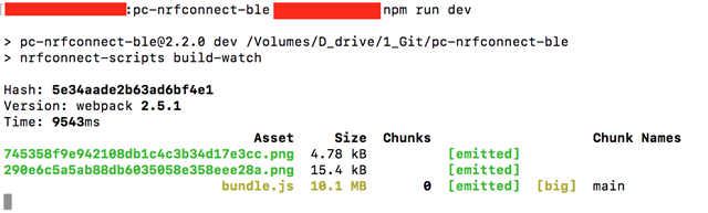

Hi all,
I would like to modify nrf connect app on mac os.
I cloned nrf connect from: https://github.com/NordicSemiconductor/pc-nrfconnect-ble
I execute commands on terminal:
npm install
npm run dev
However it stuck at command "npm run dev" and nothing happens.
Did I miss somthing when compling?

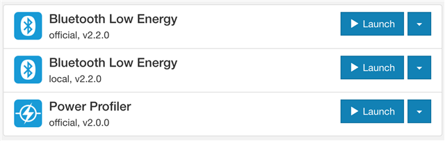

  • Sorry for the delayed response. I have tested this on my mac & I receive the exact same problem that you have. Did you remember to put the cloned folder in this path: $HOME/.nrfconnect-apps/local/? Also, you will need to install nRF Connect like shown. Then, if you have done everything correctly, which I suspect you have, you should see a local Bluetooth Low Energy application like shown below when you open nRF Connect v2.5.0
    When you launch it, the app should work successfully.
