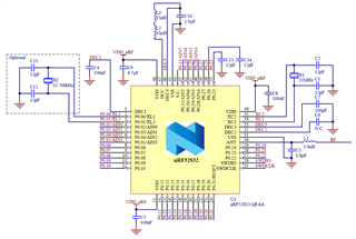

Which pins should I take out in order to program the board?
I am planning on using nrf52832 for a beacon application. I happen to get a schematic and layout from Nordic website for development.
I am attaching the schematic along,
I want to know why there is no ground pin and Vcc pin in the schematic ?
which pins should I take out in the schematic in order to be able to program the nrf52832 board ?
Will I be able to use it if I develop the board from that schematic and layout itself or should I add anything else to it?
nrf52832_qfaa_dcdc_schematic.pdf
nrf52832_qfaa_dcdc_pcb.pdf
I am new to this and I have no idea on BLE and programming so I appreciate if anyone can elaborate the steps.
Thanks in advance.

  • Will i be able to program the chip with that ?
    As a beginner, no.
    Again, you really need to get an nRF52DK - and learn the basics on that.
    Then, once you have gained sufficient knowledge and experience on that, you will be in a position to work out how to hack a Nucleo board.
    But hacking an unsupported, non-standard approach is really not a great way for a beginner to start!
    Alternatively, you might want to start by learning the basics of microcontroller development on your Nucleo board. It is certainly a simpler platform.Then come back to Nordic & nRF52 when you've gained sufficient knowledge and experience on that.
    As with anything, you need to learn to walk before trying to run a marathon!
