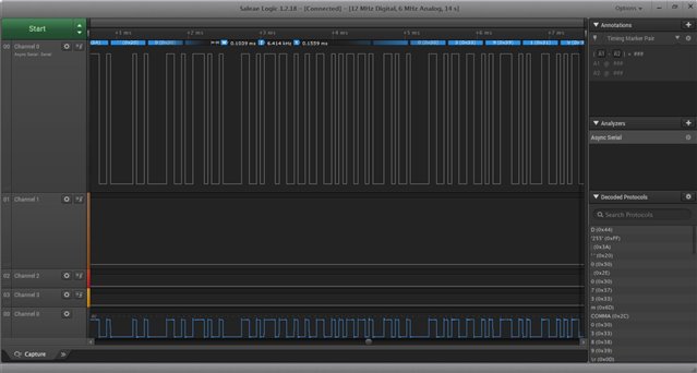

nrf_serial_read function not able to read any data , but there's data on the UART pins which are configured for the purpose.
Hi everyone,
I am using the following files to configure uart for laser distance sensor.
Serial Library
I am able to write command to the Laser sensor and also the laser sensor is responding to them( It makes a beep sound when it responds).
I also tested the TX pin of Sensor using Logic Analyzer , And it shows that there is data on the pins.
Here is the code that i have been using.

NRF_SERIAL_DRV_UART_CONFIG_DEF(m_uart1_drv_config,
                      LASER_RX, LASER_TX,
                      24/*RTS_PIN_NUMBER*/, 25/*CTS_PIN_NUMBER*/,
                      NRF_UARTE_HWFC_DISABLED, NRF_UARTE_PARITY_EXCLUDED,
                      NRF_UARTE_BAUDRATE_19200,
                      UART_DEFAULT_CONFIG_IRQ_PRIORITY);

    ret = nrf_serial_init(&serial1_uart, &m_uart1_drv_config, &serial1_config);
    APP_ERROR_CHECK(ret);
    SEGGER_RTT_printf(0,"error:%d\r\n",ret);
    return SUCCESS;

    char tx_message = 0x44;
    char rx_message;
      ret_code_t ret;
    ret = nrf_serial_write(&serial1_uart,
                           &tx_message,
                           1,
                           NULL,
                           0/*NRF_SERIAL_MAX_TIMEOUT*/);
    ret = nrf_serial_read(&serial1_uart, &rx_message,1, NULL,0);
    nrf_serial_rx_drain(&serial1_uart);
    (void)nrf_serial_flush(&serial1_uart, 0);
Also the screenshot of Logic analyzer.
