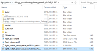

3. Currently when I try to build the "light_switch_proxy_server_nrf52832_xxAA_s132_6_0_0.emProject", I get the following error:
Building ‘thingy52-mesh-provisioning-demo’ from solution ‘thingy52-mesh-provisioning-demo’ in configuration ‘Debug’
1> Compiling ‘main.c’
2> Compiling ‘rtt_input.c’
3> Compiling ‘mesh_app_utils.c’
4> Compiling ‘nrf_mesh_weak.c’
1> C:\bluetooth-mesh-research\nrf5_SDK_for_Mesh_v2.2.0_src\examples\light_switch\thingy_provisioning_demo_generic_OnOff_BLINK\src\main.c:38:10: fatal error: boards.h: No such file or directory
1> compilation terminated.
4> C:\bluetooth-mesh-research\nrf5_SDK_for_Mesh_v2.2.0_src\examples\nrf_mesh_weak.c:38:10: fatal error: nrf_error.h: No such file or directory
4> compilation terminated.
3> C:\bluetooth-mesh-research\nrf5_SDK_for_Mesh_v2.2.0_src\examples\common\src\mesh_app_utils.c:40:10: fatal error: nrf.h: No such file or directory
3> compilation terminated.
2> C:\bluetooth-mesh-research\nrf5_SDK_for_Mesh_v2.2.0_src\examples\common\src\rtt_input.c:42:10: fatal error: app_timer.h: No such file or directory
2> compilation terminated.
Build failed

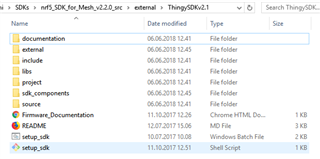

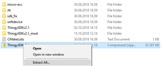

    1) Looks right to me. If you happened to press Extract All, I have noticed that another folder appears underneath the extracted folder. See below:
    Make sure that both the ThingySDKv2.1 & the thingy_provisioning_demo_generic_OnOff_BLINK folders go right to the content instead of something like this: external/ThingySDKv2.1/ThingySDKv2.1/. I hope that makes sense.
    2) This one:

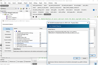

    3) Did you do step 9 correctly? The path should look similar to the screenshot below
    1. Make sure you followed the SES.md guide in \doc\getting_started in nRF MESH SDK v2.2.0 of adding SDK_ROOT macro into SES, the same as when you started with Mesh examples.
    Kind Regards,
    Bjørn
  • Hi Bjørn,
    I only had the SDK_ROOT and not the MESH_ROOT, that's where it went wrong. Thanks
