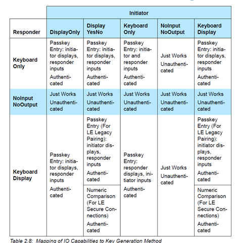

Suggest bonding model where central is exposed to public and lacks meaningful IO, the peripheral is private and has good IO, and NFC isn't available
Nordic Semiconductor-ites and fellow forum members have yet to steer me wrong so here we go.

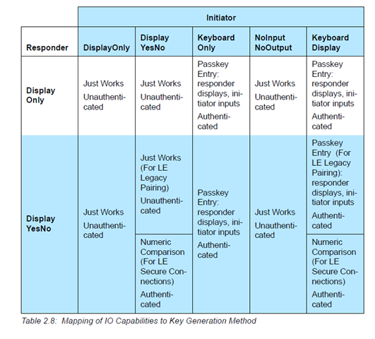

My product has 52832 on both sides. The central and its 21col x 2 row LCD display are publicly viewable and accessible... and irrelevant because I can't touch it.  I can do whatever I want with the '832 on the central but the '832 doesn't own the display: The display is owned by a processor that I can't touch without taking it back through UL so that isn't going to happen.
The other side is a battery powered remote display. As such it's fitted out with a nice 20 char x 4 row LCD panel and three push buttons.  The '832 in the remote owns everything (thank you for the extra horsepower that makes this possible, Nordic).  I'm having a brain fart trying to figure out how to securely bond these devices and restrict characteristic writes to encrypted, MITM-avoided links.  I suppose what I need is a secure procedure.  Note that NFC should be but isn't available.  Thank you in advance from both myself and kitty.

  • Thank you. I was afraid that'd be the answer.  I'm going to need to authenticate the peripheral in some other way because the central's physical security can't be assured.  Seems I need to persuade the hardware guys into giving me some i/o on the central, perhaps a physical key lock, so that I can inhibit pairing unless the key is in the lock when the devices are introduced to each other.
