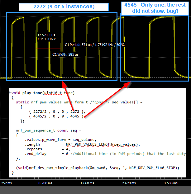

How to use PWM Waveform mode? Having issue with last sequence completing.
Despite all the questions on this forum for how to change PWM frequency on the fly, I found no mention of anyone using "WaveForm" mode. Perhaps it's new? There are also no examples available so I'm trying to figure it out myself.
https://infocenter.nordicsemi.com/topic/com.nordic.infocenter.nrf52832.ps.v1.1/pwm.html?cp=2_1_0_46#concept_pzc_1pw_nr
The code below works, but for some reason, the last duty-cycle and top_value will only play one cycle even though I have 'repeat' to more than zero. If I put {0,0,0,0} in addition to the sequence, the waveform will complete, but cause some unwanted behavior on my output.
TODO: Add oscilloscope screenshot.
I'm an amateur programmer, so is there an example on how to use WaveForm Mode? I plan to have multiple sequences, so an example on how to update the sequence after the initial seq_values array would be nice
The code below is heavily stripped down so it may not actually compile.
SDK Version: v15.0.0
Thanks!

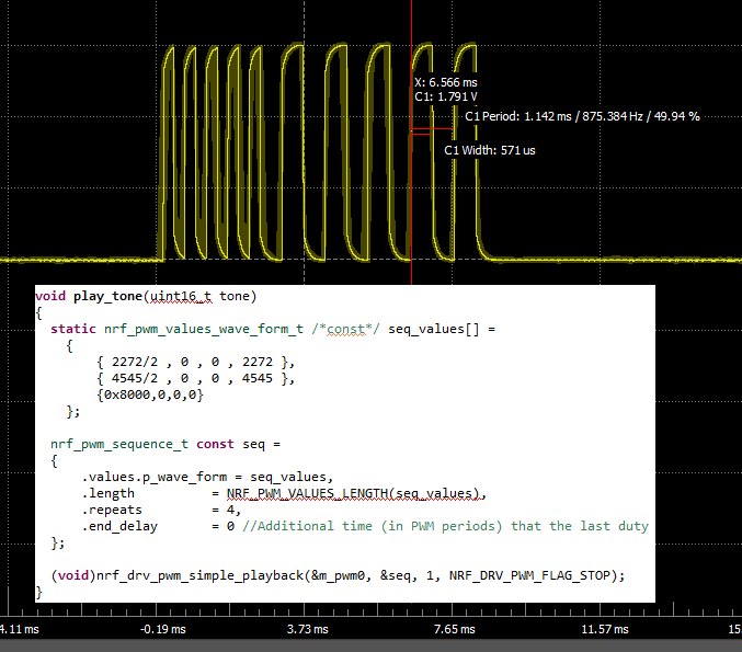

  • Here are scope captures of what I'm seeing. I actually was able to mitigate the "odd" behavior (prolonged high level) of having to add the {0,0,0,0} by simply inverting the polarity with the 15th bit by using {0x8000,0,0,0}.
    This may be a bug, though it has an easy work-around.
    waveform_missing_end_sequence
    waveform_with_complete_end_sequence

  • Hi Edvin,
    Thanks for your response. The explanation about the inverted pin is helpful. Here are my two questions/points.

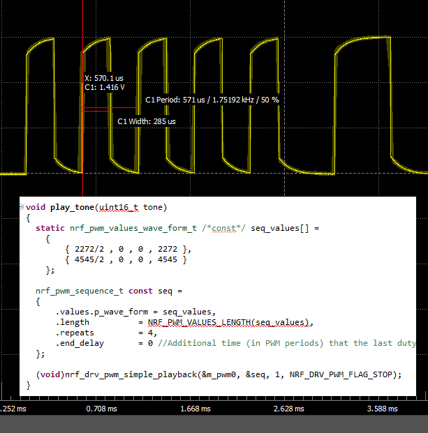

    1) I think there is a bug in the waveform driver. I've annotated my screenshot to show that I expect four sequences of 4545 frequency value, but only get one pulse. The "fix" to mitigate this behavior is adding the third sequence of 0x8000.
    waveform_missing_end_sequence annotated
    2) If there is a complete example program of PWM WaveForm mode available from Nordic? I would like one.
    Thanks.

    I see now. I tried your snippet, and I see that the last sequence only has one pulse. I thought it had more, but that it was cropped away from the screenshot.
    I don't know why it does that. Let me ask someone who has worked on the PWM drivers. I will get back to you.
