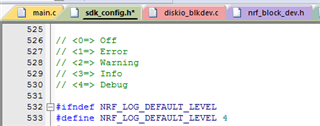

    2. If you haven't done so already, can you set the log severity level to 'debug':

    2. I have set the log severity level to 'debug' but the output is the same.

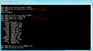

  • Are you using an nRF51 DK? How have you wired the SD card shield to your device?
    A colleague of mine actually had one of those shields and I tested it with a KINGMAX 16GB SDHC card that I had laying around. It works fine for me if I connect VCC on the shield to 5V on the DK kit, but I get the "Disk initialization failed." if i connect it to Vdd on the DK:
    For the record: Your SD card shield comes with a 3.3 V voltage converter and voltage level shifter for the SPI signals, but Vdd on the nRF51 DK is typically closer to 2.9 V. So that means that your SD card operates at 3.3 V, but the nRF51 operates at ~2.9 V. This means that you are operating outside the Absolute maximum ratings of the nRF51 and you risk damaging it (max GPIO input voltage = Vdd + 0.3 V). If I were you I would modify your shield to bypass the 3.3 V voltage converter and supply the SD card with Vdd from the DK directly, or I would look for a shield without all the unnecessary components. I believe SD cards should be able to run at 2.9 V so you shouldn't need the voltage regulator or level shifter.
