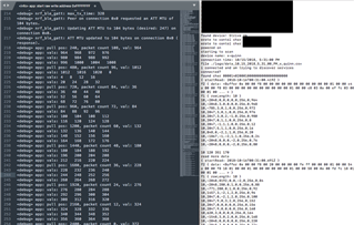

Output:
The values on the left are rtc ticks for data the is collected at 1/4th the frequency (so they should increment by 4, with a max value of 1020 as 1024==0)
These values should line up with the right most column of the data in the right half of the picture, but this data has the jumps in it. in the first data set there are jumps from 980->8 (1032) and 24->76
