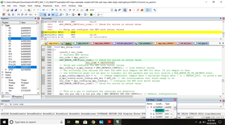

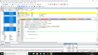

  • After your suggestion i ran a debug and found error code 0x0000000D

  • The example you are using is initializing the UART peripheral. The UART use P0.05 as RTS pin by default (RTS_PIN_NUMBER is defined in pca10040.h BSP file).
    Did you change the pin used by UART? If not, you will not be able to use P0.05 for SPI interface.
    Please clarify if you are using TWI or SPI. You mention both in your post.
