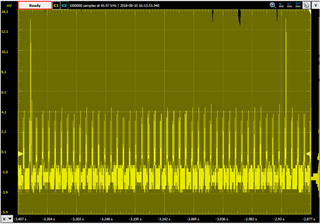

Hello!
I have a question about the slave latency: I know how it should work, I would like to know if it is normal that there are current peaks in the supply current when a connection event is skipped? See the figure below, there are 2 high peaks which indicates a connection event, and between there are the connection events which should be skipped but there are still current peaks. Is this behaviour normal?
If yes, increasing the connection interval would be better to reduce the average current consumption than using slave latency. Is that right?
