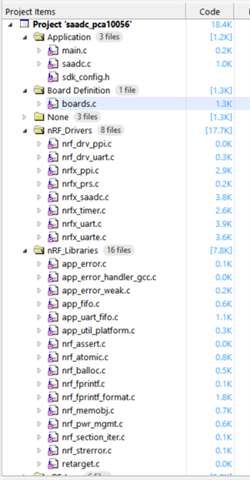

I am new to Nordic; I tried to use saadc as a base project and merge uart project (both under C:\Nordic_Semi\nRF5_SDK_15.0.0_a53641a\examples\peripheral);

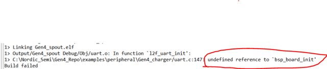

the merged project have issues below:
I checked that I defined path and configuration file; I do not see any problem.
I tested both saadc and uart project running fine; and merged project also runs if I comment out one feature (say uart), the another one saaac will run as usual.
I have been work on this for over one week; it stooped me go noway.
Please help.

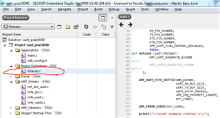

  • Apparently you are using a function called bsp_board_init() in your project, but your compiler doesn't know where to find it. If you look in the uart example you will see that bsp_boart_init() is defined in a file called board.c which is located at \nRF5_SDK_15.0.0_a53641a\components\boards\. Have you included this file in your project?
  • Yes, please see:

  • Those are just include paths that show your compiler where to look for header (.h) files. You need to include the source (.c) file in your project as well:
  • Can you please put your project files in a .zip file and upload it so that I can try to compile it myself?
