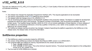

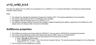

Proper IROM and IRAM settings.
I am basing on examples for PCA10040 board with 52832.
Now I want to make some app for 52810.
I want to use softDevice s132 version 6.1.0.
I am a little bit confused about setting proper IROM and IRAM, because in different version of s132 I see different answers about IROM and IRAM.
Could You help me with choosing right IROM and IRAM settings for 52832 and for 52810?
