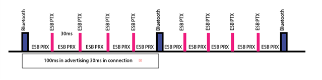

I have a problem with timeslot ESB library with Bluetooth LE. In my application i need do somethingh like that:
Bluetooth and ESB PRX works excelent, but I need to send some brodcast data ( without ACK ) in period 30ms via ESB PTX.
Is this possibile?
I'l try something like that, but without success:
esbDisabled();
esbInitTxRx(ESB_PTX);
txMasterPayload.data[0] = counterrr++;
txMasterPayload.data[1] = 0x02;
txMasterPayload.data[2] = 0x03;
txMasterPayload.noack 	= true;
txMasterPayload.pipe  	= 1;
txMasterPayload.length  = 3;
nrf_esb_write_payload( &txMasterPayload );
nrf_esb_start_tx();
// after ~20 ms
esbDisabled();
esbInitTxRx(ESB_PRX);

How to quickly switch from PRX mode to PTX mode, send some data, and return to PRX mode?
