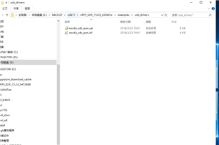

yes i do it,but now i meet a new problem;
the problem:
window10 :can find msc device and acm device;
window7 :only can find the msc device can not find the acm device ;report the error that the drive programe can not find at the windows7 system;
so why?
also app_usbd_string_config.h ;
how to assign the file
Please go through the "step 3" on how to install the driver here, under "Testing".
first thanks your response:
i can not find the drive programe;
