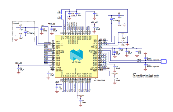

Hi there,
Is there a specific sequence needed to power-up the NRF52840?
Let me get into the details:
  • My design uses configuration #5 from the datasheet (see below)
  • Due to my power tree,  in certain conditions (e.g. no battery connected or battery dead), when plugging USB, VBUS will appear up to on the pins of the NRF52840 ~5ms before VDD_nRF actually ramps up.
  • Is this a potential issue for the chip?
  • I have monitored DCC and DEV3V3 outputs in the period where only VBUS is ON and havent spotted anything specific but I thiought this worth checking with you anyway to see if you see any risks
Thanks for your help,
