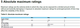

nRF52832 I/O voltage

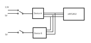

I have nRF52832 connected to a device(A) which can operate from 3.3V to 5V supply.
When the device's supply is 3.3V, it communicates with nRF52832.
Before the device's supply is switched to 5V, I will disable the nRF52832 I/O pins connected to it.
After supply switching, nRF52832 is still working, device(A) will communicate with device(B), I/O 5V level.
Will this cause damage to nRF52832?
