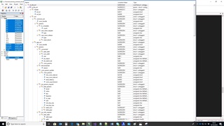

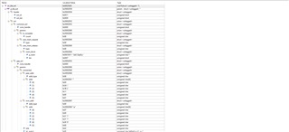

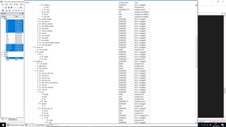

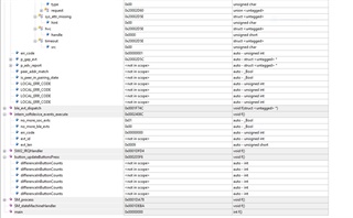

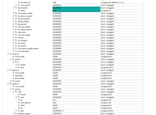

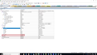

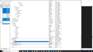

I am working on a project in which two devices(one is central and other is peripheral ) uses Nordic bluetooth controller  for connection and data exchange. nrf51822 for peripheral and nrf51422 for the central. I have random disconnection when I try to send too many messages from the remote(central) to the peripheral.
The short range disconnection happens by pressing the buttons on the remote in a fast random manner at a distance of 20 metres from the peripheral. The issue does not  happen, when the same buttons are pressed randomly fast in a close range(5-10 m) or if the buttons are pressed not so fast at long range(> 30m).
The analysis points to the fact that, when packets/messages sent from remote to the wheel is very high, some of the packets are lost and disconnection event is triggered by the soft device.
From the stack collected at the point of disconnection, the reason is BLE_HCI_CONNECTION_TIMEOUT and this happens because the supervision timeout is hit (no packets from the peer is received in x seconds).
The stack traces were collected both at remote(central) and peripheral  and both points to BLE_HCI_CONNECTION_TIMEOUT. Attached the stack traces(Remote and wheel).
Below are the BLE connection interval and supervision timeout

    Summarizing the issue, tx buffers are getting full when messages are sent at high rate and it results in a disconnection event.
    1, Is it possible to tell the BLE layer to clear the transmit buffers irrespective the sent message was successful or not. Which method to use, BLE_GATT_HVX_NOTIFICATION or BLE_GATT_HVX_INDICATION ?
    2, Please suggest a way so that irrespective the ACK is received for the messages, the buffer could be cleared.
    3, Does configuring as BLE_GATT_HVX_NOTIFICATION means buffers are cleared and no ACKS are needed to clear the tx buffer.
    Request you to give answers to the above queries.
    Thomas

    Can you please give the nRF Sniffer a try. It is Alpha Omega for BLE development debugging. Let me know when you have a sniffer trace, or if you have any issues with the sniffer.

    3, Yes, tried with sniffer, but could not get it follow the connection. In the sniffer could see traces of connection events but failed to see any events when data was sent.

  • Hello Thomas,
    Sorry if I wasn't clear. It is not possible to increase the MTU size on the nRF51 series, because the softdevices for nRF51 does not support longer MTU sizes than 23.
    1.1 Yes and no. MTU size is the actual message size that is transmitted on air. buffer size is how much the softdevice can store.
    1.2 If no ACK is ever received, you will get a disconnect. The softdevice will keep re-transmitting until the message is ACKed.
    1.3 Is your connection encrypted? If it is, you can enter the out of band passkey in wireshark. If you don't use a passkey, but just works bonding, then you should be able to sniff the connection if the sniffer is listening  while they exchange the keys. So if you delete the bonding information on both devices, then you should be able to sniff it.
    2.1. The HCI buffer sizes, this is not related, since you are not using HCI.
    2.2 exactly where do you increase this buffer from 3 to 6? The log should always tell you what your RAM memory configurations should be.
    2.3 Check the log.
    2.4 not necessarily. Since the MTU isn't increased when you use the nRF51, the peripheral will get events on all received messages.
    I really don't think that the buffer sizes is your cause of disconnection. You shouldn't focus at the buffer sizes at this point in time, if you want to find the cause of your disconnections. Focus on the sniffer trace. Try to sniff with encryption.
    Is it possible to send the sniffer logs?
