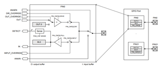

  • When low accuracy is enabled, port events are used. Ports event works in the following manner:
    • Correct sense signal occurs (PINx_CNF.SENSE, see figure below)
    • DETECT signal will be set high
    • If the DETECT signal goes from low to high, a port event happens and the appropriate callback function is called (e.g. GSensor callback)
    There are unfortunately some limitations when using high to low sensing (not PINx_CNF.SENSE) on a pin, initially when the pin signal goes from low to high, the DETECT signal will be set high and a port event occurs. At this moment, the DETECT signal is high, and no more port events will occur (which is your problem), since only a low-to-high DETECT transition will generate port events. When the pin goes low again, the DETECT signal will also go low, and new port event can occur.
