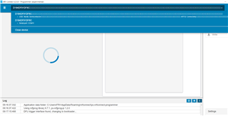

Recently I started working with the nRF52 dongle, after flashing a hex file via nRFConnect/Programmer applic (version 2.5.running on Windows 10 Pro), I no longer see my USB dongle except when operating in DFU boot mode (after pressing the reset button, red LED blinking).
Also strange I see this in the nRFConnect/programmer applic when running DFU boot mode..., the Nordic annotation seems a little bit weird.

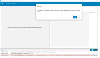

Recently I thought I bricked the dongle after flashing firmware (see also this ticket, https://devzone.nordicsemi.com/f/nordic-q-a/39596/the-nrf52840-dongle-can-no-longer-be-accessed-after-flashing-hex-file, that I closed because by pressing the reset button I could get back into it) , but when pressing the reset button I could reflash it, however I still think something is broken, as the dongle is no longer present in the Device Manager when not running in DFU boot mode, nor in the Nordic Programmer applic (See screenshot above).

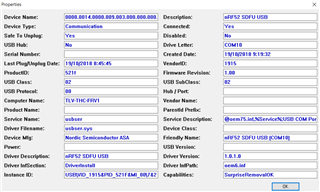

Also when running in DFU boot mode I see only the SDFU COMM in the Device Manager (see screenshot below), when I unpacked the dongle and first time insertion, different drivers where visible in the Device Manager related to the nRF52 Dongle.

After uploading the pre-compiled Connectivity firmware, ble_connectivity_s140_usb_hci_pca10059.hex,  from the  SDK V15.0.0_a53641a, and restarting the Programmer applic I see this happening (see screenshot below) and the progress circle keeps on circling for ever :

    After upload via Nordic Programmer in Windows the Device manager, shows first COM14 and after re-inserting the dongle is announced as COM11 and COM16 (See screenshot).
    Any idea how come?
