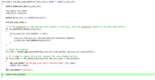

I currently use the uart-ble-central example with the 6.1.0 stack. I would like to make two changes.
1.) In the case of received data via Uart, the board jumps directly into the error case. Error 0x01 is stored in the error mask. Even after increasing the buffer size, this does not change. In addition, this case only occurs when the rx-pin is connected. The pure tx use works flawlessly.
2.) I would like to connect two peripherals with the central one. By adjusting the Counk_Links but no connection is possible.
Many thanks for your help.

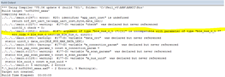

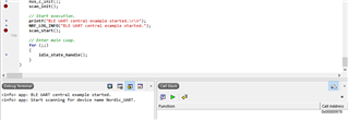

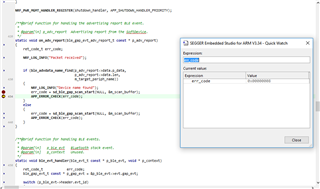

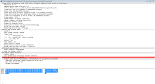

  • Hello I have solved the problem to the first question.
    To the second question. I have integrated the code of the multilink into the uart central example. The project can be built without error. however, it is not possible to establish a connection to the peripheral devices on which no code change has been made. In the SDK-config, I set NRF_SDH_BLE_CENTRAL_LINK_COUNT and NRF_SDH_BLE_TOTAL_LINK_COUNT to 8, respectively. I have adjusted the main following.

    For whatever reason, you can not establish a connection.
    the debug terminal shows the following:
    <warning> nrf_sdh_ble: Insufficient RAM allocated for the SoftDevice.
    <warning> nrf_sdh_ble: Change the RAM start location from 0x200029E0 to 0x200086F8.
    <warning> nrf_sdh_ble: Maximum RAM size for application is 0x37908.
    <error> nrf_sdh_ble: sd_ble_enable() returned NRF_ERROR_NO_MEM.
    <error> app: Fatal error

    The Output shows no errors.
       If I starting debugging, he says the following:
      After this function return he jumps into the on_adv_report();
     so I see the same error code.
    The following is described in the definition for the Invalid_state:
    @retval ::NRF_ERROR_INVALID_STATE Invalid state to perform operation. Either:
     *                                   - Scanning is already ongoing and p_scan_params was not NULL
     *                                   - Scanning is not running and p_scan_params was NULL.
     *                                   - The scanner has timed out when this function is called to continue scanning.
    However, the scan is already running and the parameter NULL is passed, so it should not actually come to this error code or have I overlooked something?

    /**@brief Function for handling the advertising report BLE event.
     * @param[in] p_adv_report  Advertising report from the SoftDevice.
    static void on_adv_report(ble_gap_evt_adv_report_t const * p_adv_report)
        ret_code_t err_code;
        NRF_LOG_INFO("Packet received");
        if (ble_advdata_name_find(p_adv_report->data.p_data,
                                  p_adv_report->data.len,
                                  m_target_periph_name))
            NRF_LOG_INFO("Device name found");
            err_code = sd_ble_gap_scan_start(NULL,&m_scan_buffer);
            //APP_ERROR_CHECK(err_code);
        else
            err_code = sd_ble_gap_scan_start(NULL, &m_scan_buffer);

    However, only the Peripheral may send the first message to the Central. The connection is available for both
  • Commenting out APP_ERROR_CHECK(err_code) to circumvent a function that returns an error is a bold move, and a move that is likely to come back to haunt you. It is much better to figure out why the function returns an error to start with, and what to do about it.
    What happens in your case is that you are using the Scanning Module and in scan_init() you tell the module to auto-connect by setting connect_if_match set to true. If you dive into the code you can see that the module stops scanning whenever it auto-connects:
    static void nrf_ble_scan_connect_with_target(nrf_ble_scan_t           const * const p_scan_ctx,
                                                 ble_gap_evt_adv_report_t const * const p_adv_report)
        scan_evt_t scan_evt;
        // For readability.
        ble_gap_addr_t const        * p_addr        = &p_adv_report->peer_addr;
        ble_gap_scan_params_t const * p_scan_params = &p_scan_ctx->scan_params;
        ble_gap_conn_params_t const * p_conn_params = &p_scan_ctx->conn_params;
        uint8_t                       con_cfg_tag   = p_scan_ctx->conn_cfg_tag;
        // Return if the automatic connection is disabled.
        if (!p_scan_ctx->connect_if_match)
            return;
        // Stop scanning.
        nrf_ble_scan_stop();
    And as you mention this causes sd_ble_gap_scan_start() to return NRF_ERROR_INVALID_STATE because scanning is not running and p_scan_params is NULL.
    I suggest that you look at the BLE Multi-link Example and how it continues to scan using nrf_ble_scan_start(). Note also how it configures an array of m_lbs_c instances in lbs_c_init(). You should probably implement something similar for your array of m_ble_nus_c instances. This might solve your current problem.
