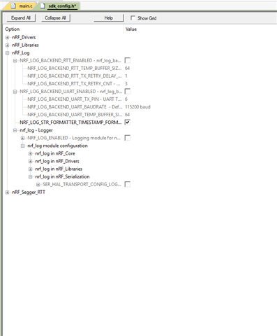

  • Do you get any error codes? What is the output from NRF_LOG?
  • Thank you for reply!
    I saw the linked program, but it seems almost the same.
    I tried to check bu writing to SD card with fatfs to judge whether I could read data securely.
    There was no error code, there was one warning.
    ../../../main.c(194): warning:    #550-D: parameter "x1" was set but never used
        static void read sensor_data(uint8_t x1)
    ../../../main.c: 1 warning, 0 errors

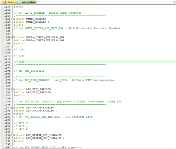

    NRF_LOG is
    Syntax error in Options Block - line 1172:
    'E' expected
    And I do not know because it has gone out.

  • The syntax error was fixed!
    Which of NRF_LOG should I look at?
