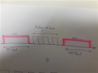

I have a RGB LED and want to have bellow process for brightness:
Red from o to 100 then Green from 0 to 100 and Blue from 0 to 100.
till now i by bellow code i can go for a white color which seems start from 0 to 100. But what i need is different because i am
unable to do it for 3 colors. I will appereciate if u help me. Moreover i am using demo1 of pwm driver example.
