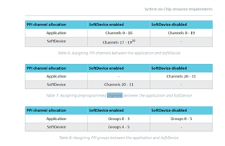

Please Let me know if I am looking at the right place for this error and also if I am missing any configurations.

    The softdevice will block or restrict access to some Hardware peripherals when it is enabled, including the CLOCK peripheral. Trying to access the peripheral registers directly will result in invalid address access.
    The restricted peripherals can be accessed through the softdevice API, specifically you can use sd_clock_hfclk_request and sd_clock_hfclk_release to start and stop the HF clock.
