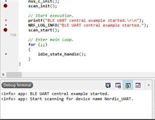

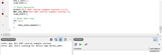

Uart BLE multilink
 I have integrated the code of the multilink into the uart central example. The project can be built without error. however, it is not possible to establish a connection to the peripheral devices on which no code change has been made. In the SDK-config, I set NRF_SDH_BLE_CENTRAL_LINK_COUNT and NRF_SDH_BLE_TOTAL_LINK_COUNT to 8, respectively. I have adjusted the main following. I use the 6.1.0 stack.

For whatever reason, you can not establish a connection.
the debug terminal shows the following:
<info> app: BLE UART central example started.
<info> app: Start scanning for device name Nordic_UART.
<error> ble_scan: sd_ble_gap_scan_start returned 0x10
<error> app: Fatal error

  • Have you tried testing with the regular multilink central plus two peripheral uart examples before you merged the multilink central with uart central? I have just tested this now & that worked fine.
    Is this all the logging you receive before you get the error?
    The error 8 NRF_ERROR_INVALID_STATE only occurs under one of the following three conditions:
     * @retval ::NRF_ERROR_INVALID_STATE Invalid state to perform operation. Either:
     *                                   - Scanning is already ongoing and p_scan_params was not NULL
     *                                   - Scanning is not running and p_scan_params was NULL.
     *                                   - The scanner has timed out when this function is called to continue scanning.
    From your last comment, it seems that m_scan in the call  null, correct? That would make sense then that the sd_ble_gap_scan_start() inside nrf_ble_scan_start() in nrf_ble_scan.c returns error code 8. Also, from your logging, it seems you did not receive any logging info from:
    NRF_LOG_ERROR("sd_ble_gap_scan_start returned 0x%x", err_code);
    Is this a correct assumption? It seems like it has to be the second case in the comment above, as scanning is not already ongoing & the scanner did not timeout.
