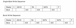

As part of the migration we are trying to do a TWI write without a stop or repeated start condition using the nrf twi manager (by dividing it into two transfers, one with the register address and one with the data to write that has variable length). Basically the following:
We are able to send a write command followed by no stop and a repeated start with the data but our slave device does not respond to this command. We are able to go around the issue by sending a single transfer packet with the register address in the first byte of the buffer but not all of our drivers will be easy to modify with this change. Is there a way to do this using the nrf_twi_mngr OR the driver directly? After perusing the documentation and the source code, we were not able to find a solution that did not require modification of the SDK.

    But as said before the only way to make it work as we need it to (image in original post) is to prepare a single transfer and pass it to twi_mngr_perform as such.

    Now back to your question, I think the source of your problem is that there is no configuration in twi_manager that gives you a sequential operation without a repeated start. The flag is only to omit a stop but there is nothing to omit a repeated start. I see that there is no easy solution for this without changing too much of twi_manager and risking untested changes.
    Let me have a look at nRFX drivers to see if we can manage to do this in easier way.
    For now it looks to me that your way of packing slave address and register address seems to be the simplest way without changing any SDK library or driver code.
    I will be back to you once I experiment a bit with nrfx drivers
  • OK actually digging around I see that it is not possible to omit start sequence between two separate TX transactions. Normally the driver is able to omit a stop condition between two transaction by using the short available in the hardware LASTTX_SUSPEND. But I am pretty sure that your sensors get confused here.
    in your workaround you avoid a stop and repeated start by keeping all of them in the same transaction. I think that is the best way to do it.
