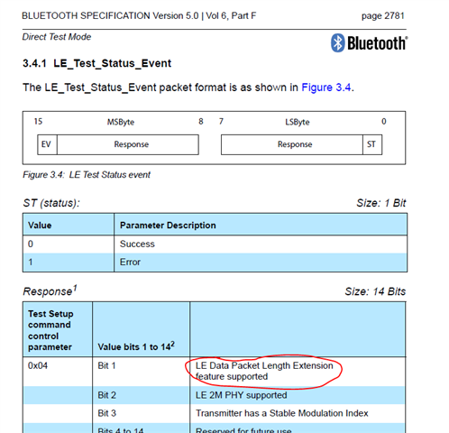

Not sure if this is related but in In BLE 5 specification (BLUETOOTH SPECIFICATION Version 5.0 | Vol 6, Part F) page 2781 I found there is some LE test status event returning byte if packet length extension  as well as 2M PHY is supported, but I was unable to find something like this in SDK.

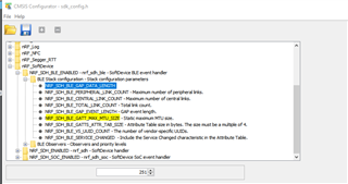

2. Do I need to enable Data length extension (DLE) separately? How to verify it is supported?
In the same ble_app_att_mtu_throughput  you are setting connection event length extension but naming it Data length extension:
    NRF_CLI_CMD(conn_evt_len_ext,   &m_cele_cmd,           "Enable or disable Data Length Extension (on or off)", default_cmd),
even though it is clear that it is connection event length extension.
In nrf528xx-ble-throughput-demo-master which is for SDK 13 you had two different parameters: connection event length extension and data length extension.
static test_params_t m_test_params =
    .att_mtu                  	= 247,
    .conn_interval            	= 400.0f,
    .data_len_ext_enabled     	= true,
    .conn_evt_len_ext_enabled	= true,
I know the difference between those two, but I am very confused if these two options are still separate in SDK 15 and how to enable and verify DLE.
