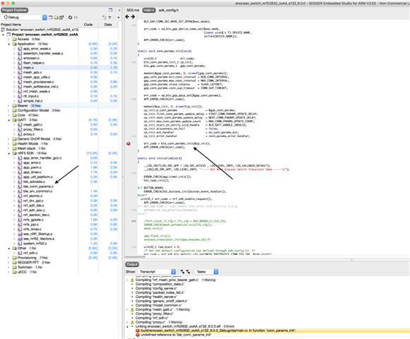

I was trying to implement the proxy profile into the Enocean switch example to try if the friend node for the switch can be provisioned using the Mobile App.
I encountered the error reading "undefined reference to ble_conn_params_init"
I included the file in the project, also included the path to the folder containing the file but this compilation error isn't being removed.
What might be the reason?
Thank you.

  • Again, the fact that the 'Code' and 'Data' columns are empty shows that it is not being built.
    Have you done a full rebuild - not just a build ?
    Have you tried 'Clean' before 'Rebuild' ?
    What if you compile just that file on its own ?
    Have you looked inside the file to see if it is all being disabled by some #if ... ?
    Your screenshot shows that you have other warnings. Are there also other errors?
    As always, fix the earlier errors & warning first.
