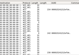

Packets are fragmented to size less than the MTU
Hello, I am using the nRF52 with SDK 15 and this is subsequent to this post and I applied the change suggested in in nrf_ble_gatt.c and having the central exchange the MTU and the peripheral comes back with 247 which is good. However the device is generating fragmented packets per this screenshot:

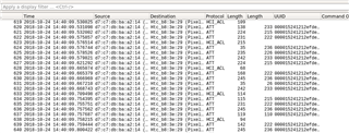

I would like the packets to be generated in consolidated fashion as here (which was generated with a different central and without the change recommended previously):
I hope this makes sense and please let me know if there is more information I can provide.
thank you,
Eric
