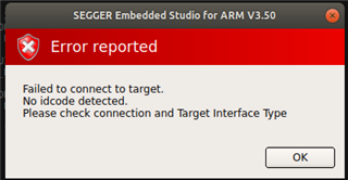

JLink cannot connect using nRF82540 DK
Hi all,
I have a Raytac MDBT50Q-DB board which I  was programming using an nRF82540-DK. It all used to work fine, but now JLink cannot connect to the Raytac board anymore and Segger Embedded Studio gives me the following error message:
Running the JLink commander (Linux version) produces the following output:
I tried running 'nrfjprog --recover -f nrf52' but that is unsuccessful too.
Is my board bricked? Any help is greatly appreciated.
  • I assume you have checked that the device is powered and the connection is ok? Can you test nrfjprog --recover --log (with the log option that is)?
  • Thank you for your reply. Yes, the target is powered and and the SWD connections are OK. I run the command 'nrfjprog --recover -f nrf52 --log' twice. Here are the log files, that look somewhat different.

  • Did you enable pinreset? Can you try to connect the reset pin to vdd and run the recovery sequence again?
  • That did the trick, thank you. I connected P0.18 to Vdd and then J-Link connected to the board. Then I used 'nrfjprog' to erase the UICR, I did not run the full recovery. Now J-Link connects and the board is back working again without having to connect P0.18 to Vdd. Not sure why.
  • The board was stuck in reset state. Connecting the reset pin to vdd made sure it could exit the reset state.
